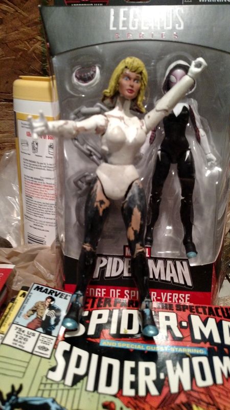

    Day 1
    Acquired a bare peekablue really cheap on eBay. I already had a spare Teela Goddess head so I sculpted the epoxy onto the face. (5 mins)
    Day 2
    I let the epoxy harden for the night (4-5 hrs usually does the trick) I sanded with 120 grade for 5 mins, and 600 for 5 or so mins. Applied foil around the body and sculpted the hood. (5-10 mins)
    I needed to make the eyes mirrored and symmetrical. An easy cheat I use is to use masking tape. Put it on the edge of a glossy index card, fold it so it's on both sides of the card.
    Cut your shape and carefully peel. (Use a sharp blade. If you screw up the reverse stencil or tear any tape trying to remove it, the card is still a double sided stencil that can be reused.)
    Day 3
    Dremmeled the shins and forearms clean, cut the emblem off the bodice, added epoxy for smoothness. Sanded hood and masked head with 120 grade and 600 grade then painted. Sculpted hair, drawn-down hood, and toes. Painted eyes GITD. Cut fingers apart then superglued to form. (1 1/2hrs.)
    I let everything harden for 4 hrs then I sanded with 120 grade and 600 grade. After that, I epoxied the crotch and forearms. **I left a notch as a marker so I could build out later after that layer hardened. This method keeps the material sturdy or solid and less flimsy. You can always sand down if needed to** (20 mins)
    Day 4
    I painted her the first coat and let it dry for an hour, then sanded every joint with the dremmel and also 80 grade, then finished with 120 grade. (30 mins)
    ***NOTE***
    Normally, you would want to sculpt everything, then sand, then paint but I wanted to show what you would want to aim for.
    Painted the toes and heels. Sculpted the crotch with more epoxy to build it out to form. Let it set for four hrs then sanded with 120 grade and 600 grade. (30 mins)
    Day 5
    Painted hair brown, painted drawn-down hood, patched masked head with epoxy. (20 mins)
    Drybrushed hair with yellow. Epoxied the bodice a little more, then let set for 4hrs and sanded with 120 grade and 600 grade. (30 mins)
    Day 6
    Painted the pink with a stencil using brushed on spray paint. Also brushed on the black spray paint. (20 mins)
    Let dry for 1 hour, brushed on white spray paint. Painted drawn hood. Detailed metallic blue, white triangle on hip, and started pink around eyes.
    (40 mins)
    Day 7
    Dremmel the neck part of the hood to allow it to sit better. Detailed the metallic blue and white triangle thingy on the opposite side then drybrushed the inside of her hair. (20 mins)
    Wasn't exactly happy with the current hood so I sculpted a more asymmetrical, droopy, McFarlane version that I feel looks way cooler. I used the GITD window paint instead of foil or masking tape because it will peel off unless superglued. (10 mins)
    Day 8
    Cut the bodice. Painted Gwen's face and hair bow. (15 mins)
    Detailed the masked head. Sanded the McFarlane hood with 120 grade and 600 grade. Spray painted white and let dry for 2 hrs, then brush painted pink and metallic blue.
    Day 9
    Your friendly neighborhood stencil maker. (5 mins)
    Sculpted the back inside the stencil with epoxy. (10 mins)
    Sanded deformation on chin with 120 grade and 600 grade. (5 mins)
    Day 10
    I let her dry overnight then I sanded the body with 120 grade only. The face I sanded with 600 grade. Applied epoxy as needed for touch-ups on the bodice and head. (10 mins)
    I then decided to outline the triangles and detail her costume with epoxy a bit more. (30-40 mins)
    Day 11
    Let it set overnight and then sanded with 120 grade and 600 grade. I painted the touch-ups and details then sealed with testor's dull coat. (notice she's not as shiny)
    After that I made another stencil and painted the pink under her arms.
    Day 12
    Added the metallic blue webbing with a toothpick, after that I did some last minute sanding with 600 grade sand paper, then finally finished details and final touch-ups. Then I coated again with testor's dull coat and let dry for several hours.
